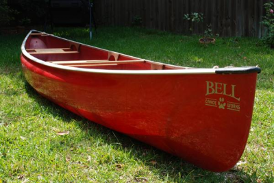

Re: What would be your ideal tandem canoe?
Bell Morningstar. Bell Canoe Works is currently out of business after buying the company a few years ago. Former owner Ted Bell has started a new canoe company (Bell Composites) and is building some different designs. The three (now) classic designs, Flashfire, Wildfire and Starfire were bought and now produced by Colden Canoes. But as far as I know, no one is building the Morningstar in any layup... fiberglass, Royalex or carbon fiber. It is a 15'6" x 32" tandem, 58# in Royalex. Rocker- Bow 2.5" / Stern 1.5". Capacity 6" Freeboard: 950 lbs. Shear Bow 21" / Mid 14" / Stern 19". It is also a solo crossover. IIRC, it is a David Yost design.
